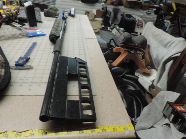

    So enter the ultra high rib...4'' to be exact! Due to the amount of steel in my neck, I'll never be able to bend neck to look flat down barrel.
    So off goes the Perazzi to Roger Eubanks in Idaho so they can work their magic on an all steel rib. They said it will be the highest rib they ever made.
    I shot my proto type high rib guns, both the Rem and Perazzi in my back yard with a 70/30 POI. So much faster to get on target looking down a rib compard to having one eye looking thru scope and other eye open. The Perazzi was sent last week and should take 6 to 8 weeks.

    Should get my TM1 with ulta high 4'' rib back today. It's sitting at the Fedx building...of all places, Vandalia Ohio at the airport. I promised my wife I won't get all misty eyed when looking over those empty trap fields when picking up my gun. Can't wait to see Roger Eubanks work.
  10. wpt
    It will be interesting to see a few pictures of it, I congratulate you for finding a way rather than give up ... WPT ... (YAC) ...
  11. rookieshooter
    Thanks wpt.
    Eubanks did a fantastic job on building this rib to my specks. It's 4'' high by 12'' long at top. Now I need to raise comb.

    The rib is all steel, made by Eubanks gunsmithing in Idaho. Simmons removed the original rib when I had the elevated red dot. By removing the full length rib, narrowing down and gutting the large Perazzi forend including removing a large amount of forend iron and the extremely light stock, the P gun is now lighter then my Rem 1100. The 1100 might be sent out to Eubanks next year.
