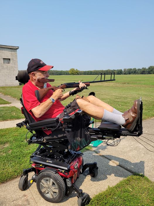

    Shot my highly modified Perazzi TM1 with a 4'' high Olympic rib by Roger Eubanks, a 12.5'' LOP pistol grip stock made by yours truly, an adjustable comb made from parts from an old Graycoil (sp) recoiling device.
    The gun only weighs 7.8 lbs. It shoots 60/40.
    Plus I had to go back to a pull trigger due to my spinal cord injury. My trigger finger won't release as fast but can pull just fine. After shooting a release since the mid seventies, I really found it easy. to swap.
    My left hand is a different story. Needed a specially built device that keeps all fingers and thumb opened up all the time since I can not open them. I can however close them since they are held open with rubber band things. In the pic you can see the left hand device.
    The chair is something else. This is the first time I ever used it since I bought it. Built like a tank. This chair will raise up, tilt forward, tilt back and even extend my legs out for better blood flow. Has Bluetooth and even a display screen and coil over shocks. CHAIR SHOOTING.jpg

  4. Mike Poore
    Mike Poore Active Member
    God bless you, Sir. An inspiration to us all. Both the gun and shooting platform, along with the rubber band left hand thingey took some study.. just amazing.
  5. rookieshooter
    Wright Patt Air Force Base OHIO.
  6. bobski
    thought it looked familiar.
    thanks.

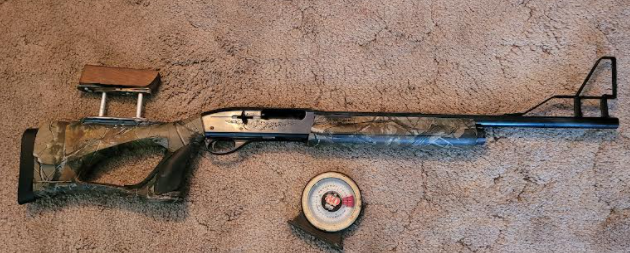

    Did some work on my Rem 1100 to remove barrel weight. What I did was to remove some of the Simmons rib up to to the point where it meets the Keen rib which is on top of the Simmons rib.
    Before the modification the barrel weight was exactly 3 lbs. Now it is 2.6 lbs.
    The part that was removed was completely useless, being my eyes are so high above barrel that I couldn't see it anyway.
    Before and after pics.

  13. rookieshooter
    Cleaning out an old gun cabinet and came across an old slug barrel for a Rem 1100. Hmm, now that's a light weight barrel and I just happen to have some left over Simmons rib material that I removed from my 1100.
    I always wanted try my hand at installing a steel rib.
    So after two cups of coffee, I started to work. First thing was to remove front rifle style sight via propane torch. This left a bare metal area about 2'' long x 1/4'' wide.
    Next was to cut down rib to a much shorter length. Then slide in the vertical posts in the slot so they align up with the bare metal on barrel.
    My biggest problem is that I do not have a jig like most rib installers use to square up the rib to the barrel.
    So after another cup of coffee, it came to me. Use some of my super powerful rare earth magnets to hold every thing in place as I sighted down barrel.
    Then solder up parts.
    Actually it's going to take longer to clean up the mess from prepping the barrel and filling down some of the solder then it took to install rib.
    Then send barrel to Keen sights to add 2 more inches of rib on top of the Simmons rib. Neither Simmons or Keen could make a 4'' plus rib that I need.
    As if all this is not enough...Briley choke tubes just might be added...wink

  14. rookieshooter
    Change of plans. Forget sending to Keen sights. I had about 6'' of Simmons rib left and not one to throw away good hardware. I slept on the idea on how to utilize this left over piece to give me the 4 + total inches in vertical height. BINGO!
    I always shoot off the end of the barrel any way. Don't need any kind of long sighting ramp no matter what anyone says.
    So I got busy building an AR 15 style front sight with the 6'' left over...more then enough.
    And how did it perform? Remember this is an open choke 22'' slug barrel.
    Set up pattern board, moved back to 35 yds. Slipped in a 1oz 7.5 with Clay dot. Rested barrel on tripod while raising my seat on electric scooter (this is like shooting from a Lazy boy recliner) and pulled trigger.
    To say I was a little apprehensive while driving to the board is an understatement. The pattern was spot on. The center of the pattern directly over the X about 60/40.
    This is good enough to send to Briley and then some more pattern time.
    The gun is so light and sooo much fun to shoot.

  16. rookieshooter
    Just off phone with Jess Briley about installing choke tubes. I was concerned about the height of the rib having a conflict with the equipment used in installing choke.
    Glad I did! The rib can not be no more then 3'' from top of rib to bottom of barrel. Mine is 5.5''.
    Well since I installed the rib using soft solder, I can easily remove it and reinstall after choke is installed...lesson learned.
    Plus I might add one more vertical post,
    cwtech likes this.

    This is a pic of the Rem 1100 with the 32'' barrel. It did have a Simmons full length rib which I completely removed. Way to heavy for me! Plus I'll have Briley cut barrel down to around 28 or 26'' with choke tubes added. They now have my 22'' slug barrel which will also have choke tubes. This barrel will be for home defense and occasional trap.
    I need to drastically come down in weight on all my Trap guns. Primarily at barrels that extend past my left hand. This is because of a shoulder operation that required cutting the bicep muscle from the bone on left arm...enough of that crap.
    Just for fun, I bolted on my red dot scope that that I used to shoot from hip.
    Back then it was 15'' above barrel. But after therapy I'm able to lift gun to shoulder for a short time. So what I did was to shorten the height to 4'' above barrel. This will be the height of the new short rib that I'll make from parts of other steel ribs that I have.
    I do believe the days of shooting those heavy 34'' barrels are over. Including my TM1 perazzi which will have the barrel cut down and end rethreaded for the .740 bore tubes which the gun has now. The Eubank's Olympic rib will be moved back and also shortened in length. I'll have enough rib left over to make another bump style rib for another gun...grin.
    First pic is shouldering Rem 1100 with red dot scope.
    Second is when shooting from hip
    Third is Eubanks rib on Perazzi.
    Tom in PA, Flyersarebest and cwtech like this.

    Just received Rem 1100 barrel back from Briley with the light full choke installed. This used to be a 22'' slug barrel with rifle style sights.
    Had to solder back on the rib I made cause the barrel would not fit in their machinery to install choke tube.
    I also removed the rear slug sight for weight reduction...the ounces take care of the pounds. You can see the rear sight if you scroll back. Even the large nut that secures the forend has holes drilled into it.
    The angle finder really made installing the rib perfectly aligned with receiver and barrel a snap.
    cwtech likes this.

    Here's a pic of both the Perazzi TM1 and Rem 1100 with the new ribs installed after Briley installed choke tubes.
    The Perazzi weighs in just under 7# and the Rem 8#s. Barrel lengths are 25'' and 22'' respectively.
    Next both gun barrels will be sent back to Briley for rebluing.

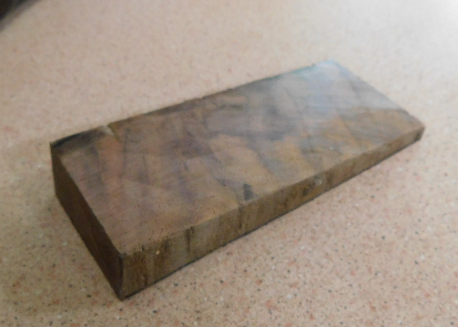

  56. rookieshooter
    I eventually had LOP down to 11'' but changed it to closer to 12'' like the Rem 1100. Plus when I built the spacer I increased the heel measurement by 1/2''.
    The recoil pad was not fitting my arm just right enough, too much at toe end.
    Pic is piece of black walnut that I'll use. This stock will be a proto type that Wenig gun stocks can use to make a custom thumb hole stock.
