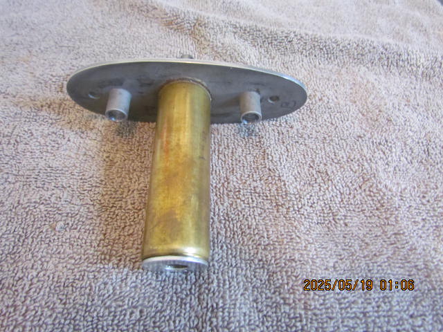

What do i have ,is there adjustments in it and how do i do it - counter coil?
Discussion in 'Trapshooting Forum - Americantrapshooter.com' started by vdt, May 19, 2025.
  1. vdt

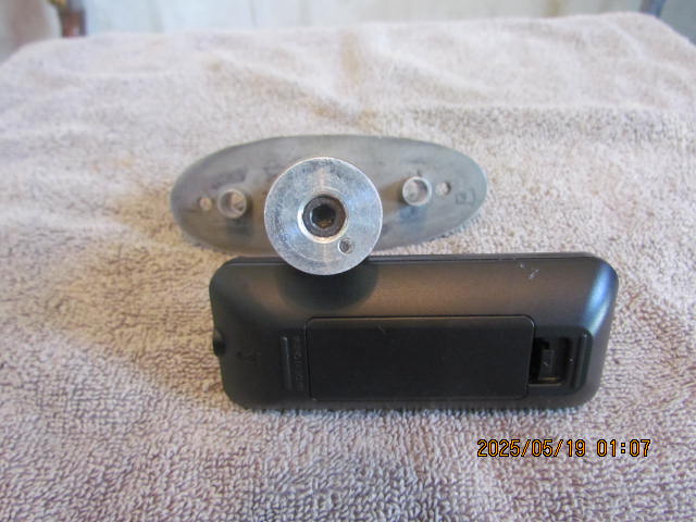

    here are 2 pictures of a absorber in a gun i just bought ,very hard to compress is there a adjustment in it ,what is the allen key head for ???????????
  2. anthony morton
    anthony morton Mega Poster
    Thats a counter coil. Turn to the left to tighten it up and turn to the right to loosen it up.
    Do not go past the stop. These adjustments control the dampening. Turn it 180 to the right to check the dampening
  3. vdt
    P.S. going to turn it to the right clock wise to see if it will loosen up ...thank you
  4. Skeet_Man
    Skeet_Man Mega Poster
    Do not remove the set screw!
    The are obsolete now, when it fails there is no way to repair or replace it, only option is to install a different brand of reducer or replace it with a pad and a big spacer.
    If it's on a gun you plan on shooting heavily, I'd replace it now, that way it doesn't fail in the middle of a shoot/season and leave you high and dry.
